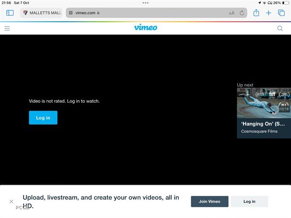

Here is a video of the issue: https://youtube.com/watch?v=zllKuIyNnHc&feature=shared

You’ll need to put it on a video hosting site and post the url link. YouTube is the obvious one and there are others.
….but I think you need to rate it so us over 18’s can view it?
Standard for Porsche brakes. Did you untick that option?
