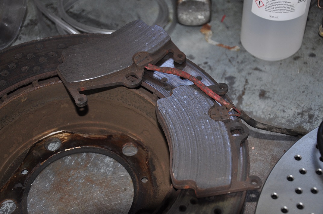

Back from a solid successful hillclimb meeting so feeling 'mechanical' today, time to fit my new rear brakes to the Boxster, and just in time too.
No lights on the dash but a chance look at the pads a few weeks ago looked like the pads were very close to finished, and so it proved.

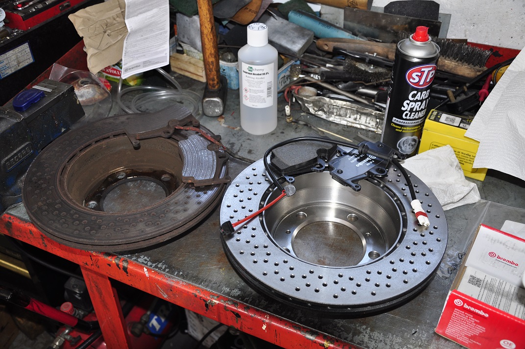

Ahead, bought a rear brake kit from Design911, Brembo no less so I had everything to hand.

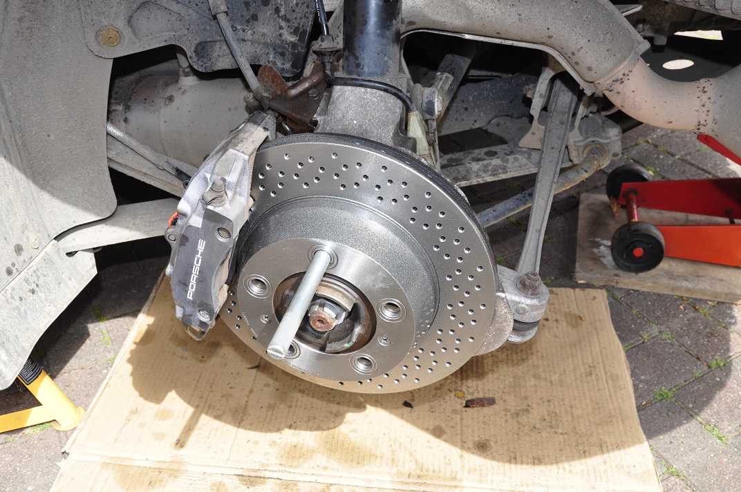

One side at a time, it all unscrewed with no issues, not bad for 86K miles and kept outside all year round. The handbrake needed easing off to get the discs off, so the 9 clicks it was set to was kept as the reference once the new discs were on.
Nice easy job so a good £150 saving in labour (I'm very very cheap though the wife does not agree...).
Will run the car round for 20 miles or so to be sure it is all OK this sunny afternoon.
Yes, both sides looked good so stayed there Jeff.
The handbrake shoes on my 1973 911 are the originals...
Car drives and brakes well, better than before, but just rough brake surfaces gripping maybe.
After the short drive around the rear discs felt much the same surface temperatures on either side, so I think this is Job-Done.
