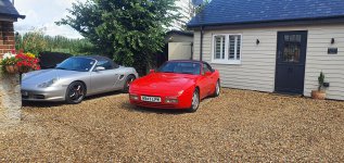

The only engine to go for is the S 3.2litre version. But if you have a 911, why have a boxster, just use the 911. The boxster is a great car. I suppose, try one out and your gonna be surprised how good it is.
As for 944, I have both, my dream car, but you need a decent one, as they are getting older now. I bought a 944s2 cab about 4 months for 7k!!!!! which is very cheap, but ive already done 3k on bits. Its ok if you can use a spanner and have a garage, then no labour costs. But if you have to pay labour then you need deep pockets for a 944! 986s Boxster is good, quick cheapish fun in the Porsche world, though.box-944-small.jpg
