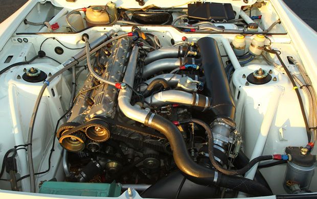

Thanks Jonny...nice pictures. Is that the engine bay of the recent Freisinger car?

The engine bay is from the '944' engined 2.5L 924 GTP, one of only 2, and very much a Prototype vehicle. Porsche wanted to call it a 944 GTP but the ACO wouldn't let them as the 944 production car wasn't due to be launched for another few months.
The Freisinger car is one of 19(ish) factory 924 GTR Customer cars with the 2.0L VW-based engine.
It is confusing and the cars are often quoted wrongly, but it is important to make the distiction, they are radically different.
