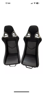

Are these available in what I believe is referred to a 'GT width'?
