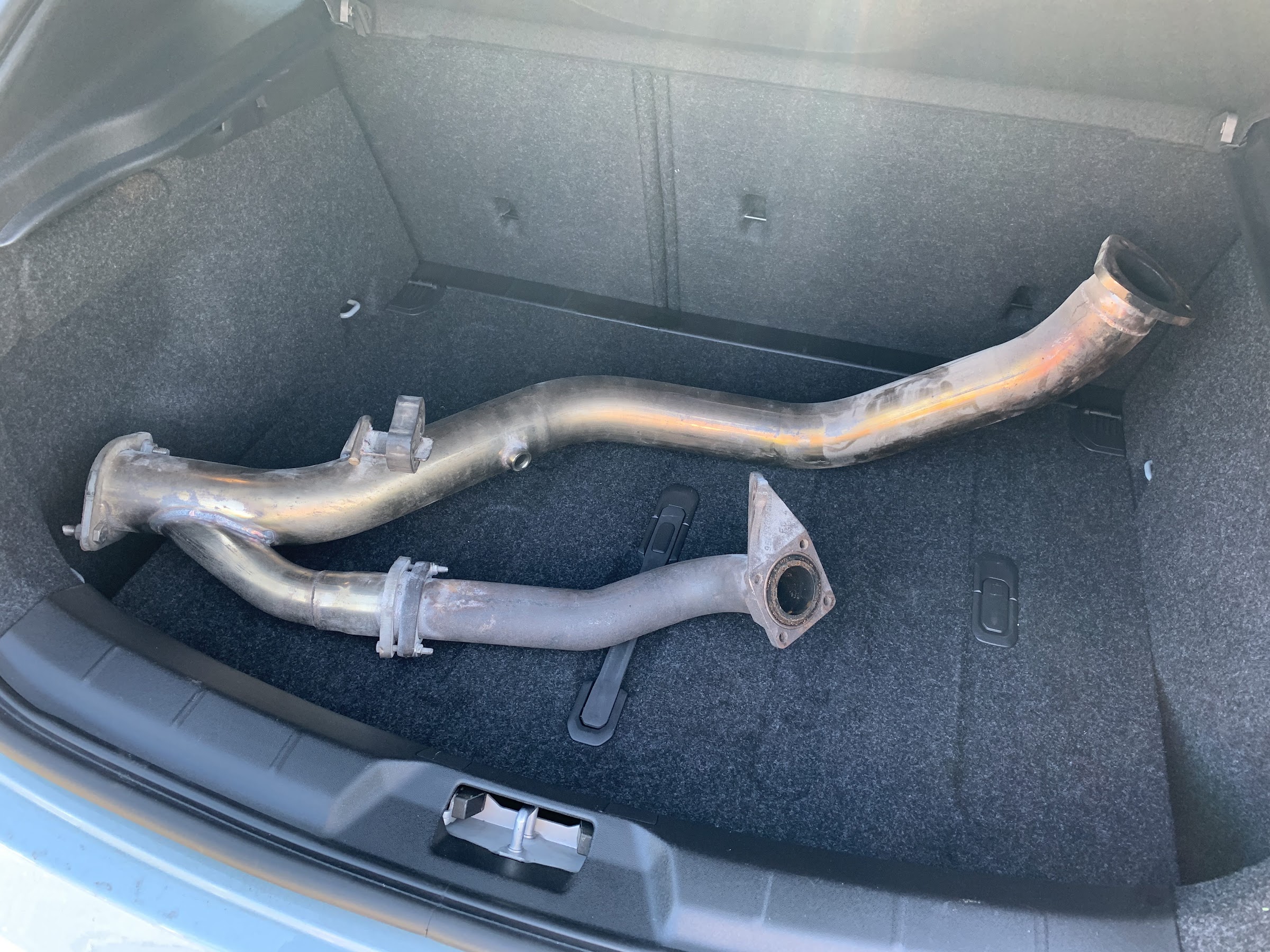

The benefits of an exhaust with a lifetime guarantee, dropped it off for some rewelding as there was a bit of a blow due to dodgy engine mounts. All sorted and ready to go back on:
