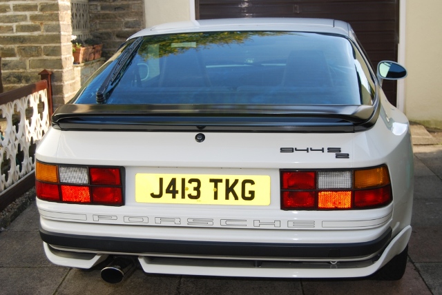

They look fantastic in white when they are clean and tidy, don't they?
that was just after a hard day's polish. It doesn't look as clean as that now !
There's a thick folder with every invoice from day 1 and all MOTs. It even has the bag for the sunroof. I had it for 18 months and did 14k miles driving 300 miles to Norwich and back once a week, and it never missed a beat. Fully serviced by Autowerke Norwich 2 months ago, and the REAL mileage is 115k!
I'm selling it because in a moment of weakness I bought a 993. Wife still not recovered from the shock [
There's a hint of rust just appearing on the sills and a tear in the driver's side seat bolster, but apart from that it's perfect. Believe you can still get the Porsche logo cloth to re-cover the bolster (can anyone confirm this?), but was too busy driving it to get it done.
