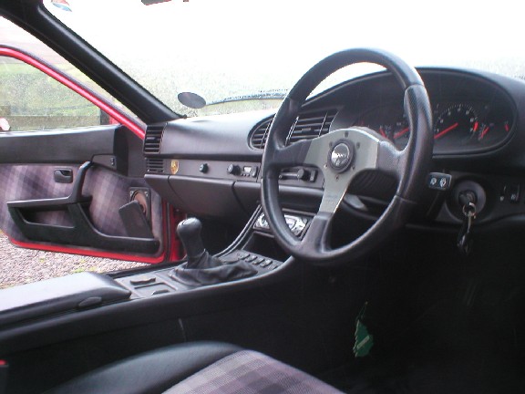

I'm hanging onto all the carpets for now as it'll be going back on the road eventually if all goes to plan.
is it worth taking all theinterior out? i.e the lower parts of the rear seats, all the carpet that covers the rear wheel arches, what about the centre storage space and all the trim around there and the door upholstery? all worth taking out?

ISTR most of that stuff is pretty light. I weighed my rear seat base and it came in at something like 1kg. I did save 12kg though by stripping out everything to do with the stereo system I had (head unit, 6 disk changer, front & rear speakers, cables probably some other cables that don't do anything).ORIGINAL: Globe_911

re: seats we've decided on a pair of cobra monaco's as they're relatively cheap and seemed to do the job nicely in our old lotus but wondering how they attach to the floor? as the passenger side will want to be fixed in place and the drivers side adjustable for different drivers? is it best to take it somewhere to have these fitted when the rollcage is put in?
cheers

The passenger side should be Ok. you may need to turn the side mounts back to front but they should fit straight(ish) into the holes left by taking the sliders out.
Fitting cobra seats to Porsche sliders can be tricky, I think the GT version (fat arsed model) might be an easier fit or you may have to do a little bending of the sidemounts or add some spacers. Just make sure that you can get in the car with your helmet on once they are in place.
