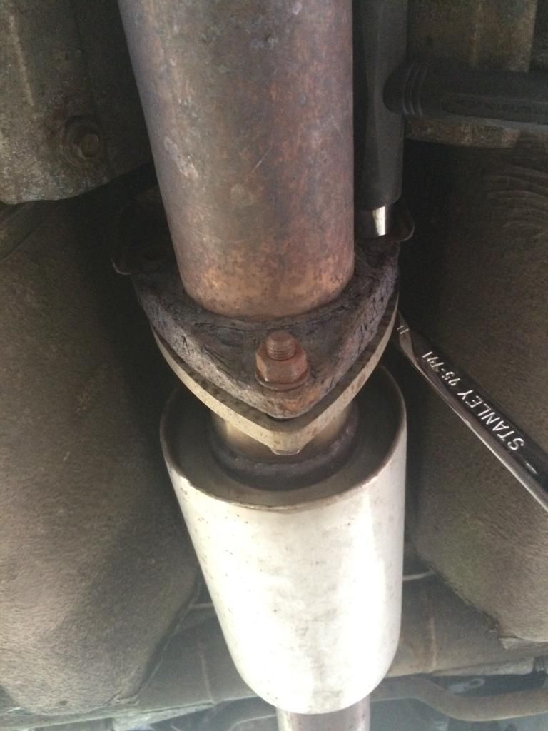

Once i have the Cat bypass fitted i will have the whole Promax power upgrade kit installed, Chip, Bypass and K&N air filter, it already has the K&N air filter, I've ordered a cleaning pack so will give it a good clean out and oil when that arrives).
