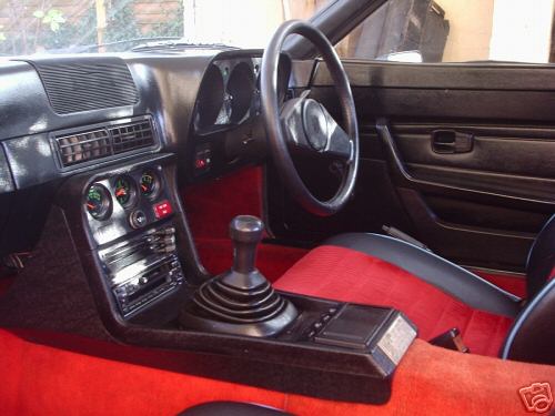

Interior does look good.

  • Also I thought that early cars had the word PORSCHE embossed in the top of the door trim ( aka door card)
  • If it had side repeaters at all they would have been orange.

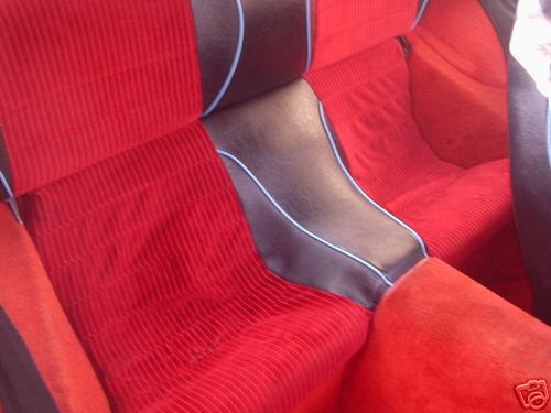

  • The interior is in my opinion a retrim as the fabric hangs too loosely in the photos of the rear seats.
  • Be aware that the commemorative plaque is attached only to the centre console and could be transferred unscrupulously.

The door cards on mine are plain without the embossed logo.

There are about 64 different door cards listed on PET, believe it or not. For example, The left hand door card LHD is different from the LH door car RHD as the left hand door has location for two window switches if the windows are electric. Add in the trim variations and the numbers soon mount up. As I had an 83 car without the embossed logo, and an 82 car with it, you can see why I asked if the door card should be embossed.
Also my annoyingly acute eyesight spots green characters on the centre gauges and white characters on the three big dials, is this correct?
ORIGINAL: 924nutter
My old 83 lux had embossed door cards.Wonder if embossed cards had an option code?
ORIGINAL: 924nutter
I would suspect a replacement instrumnt panel from an early '44 - they have yellow characters.

The centre gauges are from a 924 turbo by the looks of it. If i didnt already have a full drive way i might have had a go at it as well. The martini is my favorite 924 ever, closely followed by a 2 tone beige 924 turbo !!
