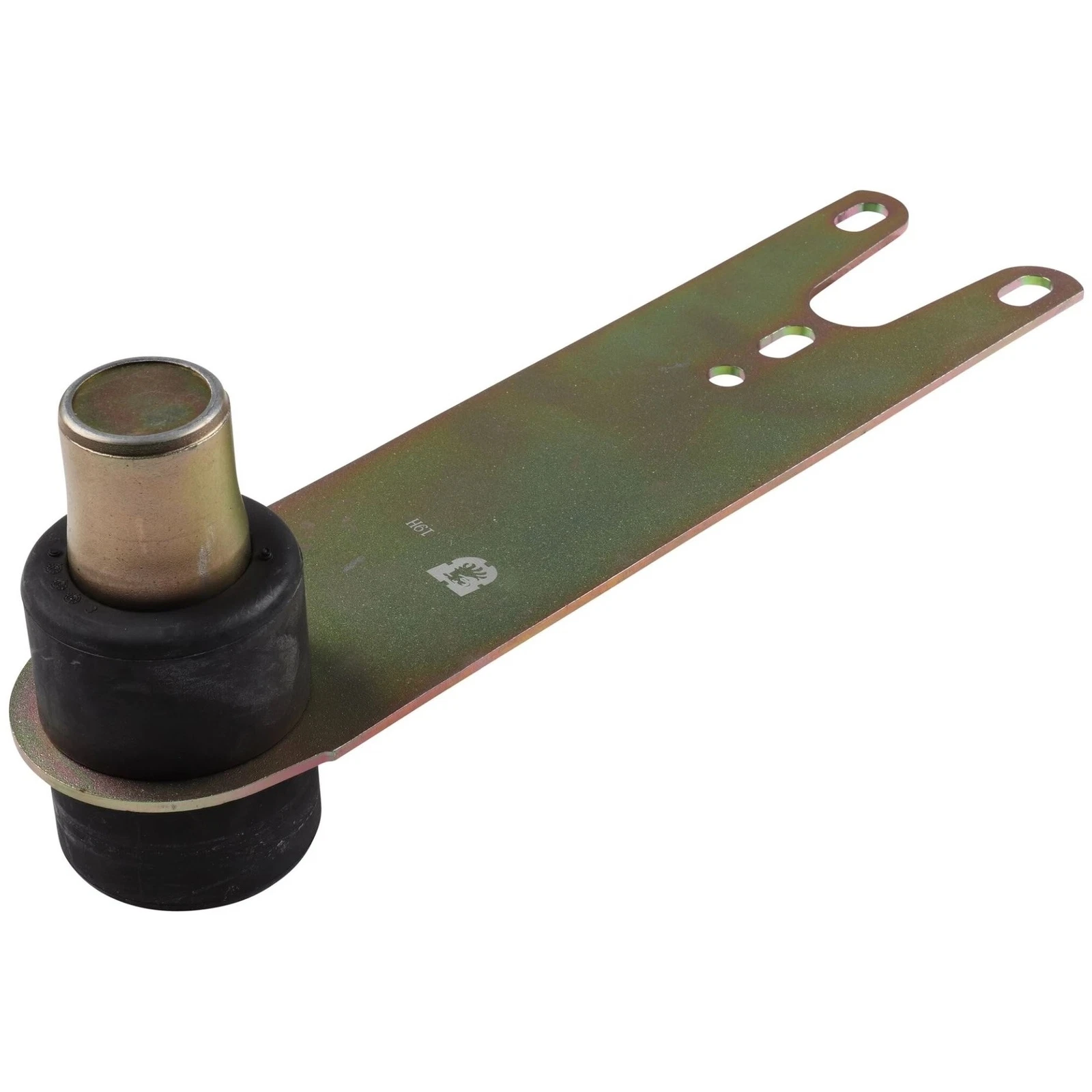

If the one side is down on the other then the torsion bars need adjusting to get the lowest to meet the highest.
The front is very easy to do, just a 10mm A/F ring spanner (!) which will raise the front. However....
The rear will also need a similar tweak and that is far more complex.
The procedure is nicely detailed in the Haynes Manual on the early 911's and simple to follow, but it can/will be a sod to do.
I personally would search out a good Porsche independent versed in these early car for the job. If the car 'level' is a mile out (ie 20mm) then adjusting the torsion bars can affect the toe-in front and back, so really a shop with all the right equipment but the right people to use it is the best way.
