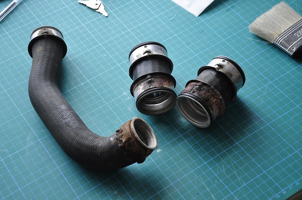

Early start in the 'cool' air of 20C and off with the front and middle undershields. Coolant everywhere.
The two short connections from the subframe plastic side tubes to the longitudinal tubes to the engine (#28 on the Porsche diagram) were leaking, as in dripping, both of them, but one worse than the other. Got them both off with ease(!) and caught 80% of the coolant.
Over to Porsche and bought (in stock) two #28's and back home and clucked cleanly back in. They were ready to be changed...
Ran the car up, burped the system several times, and got it hot enough to run the rad fans for 5 mins.
Not a drop anywhere. Levelled the car and ran it hot again, all looking good. middle shield back on and decided to let it stand overnight and run it up to fans-on-hot and see.
If dry, wheel shield back in and a good run and check when home.
Sounds like a result Graham, and lucky [!] to have separated the couplings without damage. Fingers crossed that's fixed the problem.
Jeff
indeed Jeff, nobody more surprised (relieved?) when they eased out almost as if they were new, both sides too!
Fingers crossed for tomorrow's run up and run out being dry of coolant.
