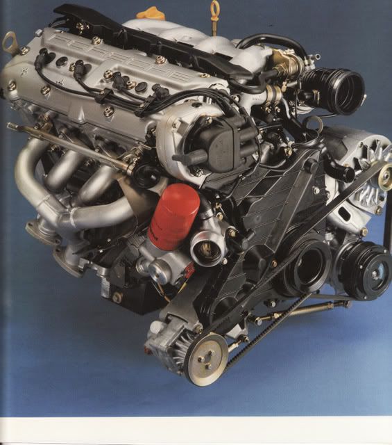

S2 engine press release picture from summer of 1988

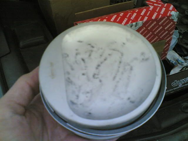

Nothing new here. People have build 3.0L turbo engines using 2.7L head, S2 block & crank for some time. Pistons can be bought from few places to this setup. I had 4 factory new 2.7L heads. Sold two of them to to friends 3.0L turbo build ups. Still have two left. Will put them to my warehouse to wait better days. Next own engine will be 16V 3.0L turbo. Have all parts already collected.
Here's Mahle 3.0L 8V turbo pistons, sorry about picture quality, used my cell phone.

Do I get a point for spotting the prototype 'plastic' oil sump in Oli's '88 S2 press release pic? Did any of these ever make it past production sign-off?
ORIGINAL: os951
Not sure of the oil pan, is it plastic, metal or what ever.
Interesting to see how all valve covers & cam gear housings have changed color during the years. That "silver" is how even production ones came out off the factory. At least the ones i checked out back in autumn 1989 had that color.
