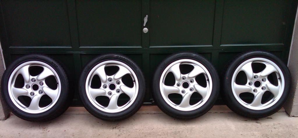

These... Picked a set up for ÂŁ96 on fleabay, were a bit corroded so got them refurbed by Lepsons.
They are 55mm offset, which is why I thought they would fit as the S2 D90 fronts are 52mm offset. Rtec have fitted the wheels but used the 18mm spacers I had on the rear as they said the fronts would not fit. The 18mm are too large as the tyres are rubbing the arches.

Edd, I tried these wheels off my Boxster on my 944 at the weekend and used a 7mm spacer on the front. It fits but pushes centre cap out a little. Alasdair says if you take the hub cover off it will give more clearance and sit ok, will probably still need spacer though.

I'm not really used to the look yet as they seem big for the car, I guess I'm just used to 16' wheels. Ride is very similar to the 16's on S02's, perhaps a tad harder on bigger bumps but its pretty minimal, surprising as I believe the AD08's have pretty hard side walls, but then so do S02's. Not had the chance to test the tyres yet due to current conditions but they seem to work very well even in this cold weather. I have ordered 7mm spacers from Jasmine, I'm assuming the dust covers will need to come off to as there doesnt seem much room even with the 18mm spacers on.
