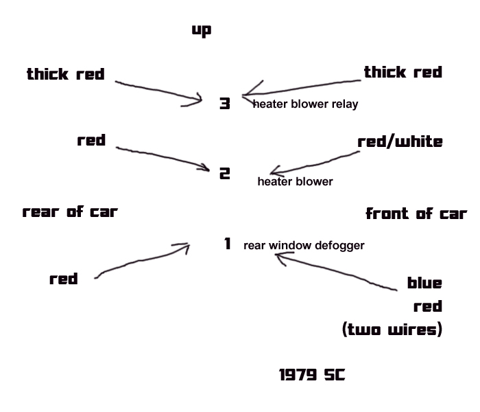

The trouble is i've just sold my SC and it now lives in France - so a bit far a way to nip out for a look.
I even looked at the back of my Haynes manual at the wiring diagram - but I understand them even less than I understand Sudoku.
Come on guys - someone out there must be able to nip out and have a look?
bones
I 've made a diagram for you , this is a 79MY car and people may have changed the wiring in the first five years of ownership before I got my hands on it. The wiring colours don't make sense to me according to the wiring diagrams so tread carefully but eveything works ok in my hotrod. I had a little difficulty recognising the exact coulur of one red wire as it was a little burned and discoloured, also the wires are old so recognising for instance if a red wire was brown or a dirty red or brown/red was difficult. Most are as written.
