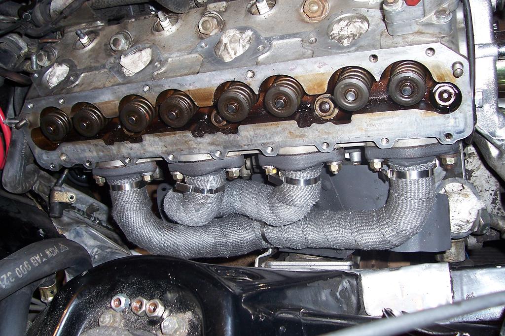

Alright Will , I rapped my manifold just as effective and a lot more economical , Unless your doing for show purposes not a lot of people get to see the manifold . Become a Rapper Will

Since becoming a Rapper I now wear a baseball cap back to front every time I drive the 944 Turbo , but apart from this I can not say I have noticed any difference thank you.
Internal followed by external ceramic coating is preferable. A good DEI wrap on top wont do any harm either: the more heat that you keep in the better.
