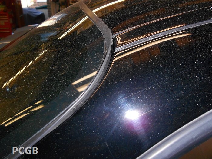

Windscreen agro
- Thread starter ignatzcatz

The windscreen is not recessed which suggests the extrusion (trim around the glass edge) has not been seated correctly.
One of the most common problems on 997 windscreen replacement is wind noise on the near-side, and this is from the [PUR] adhesive bead not making contact with the glass as it should. This is usually because the bead was knocked over on [windscreen] lift on, or that the bead was applied in the wrong place.
If the windscreen is not a genuine Porsche branded product, it will not fit as well as the OE version.

The tale continues. The windscreen people visited me and fitted the third screen. By this time the rear view mirror which had never been correctly re fitted and had been swinging in the breeze had detached wiring and the covers for said wiring had all come off. So the third screen in and, well golly gosh and other expletives, still the surround stood away from the bodywork in the upper offside area. Now I'm off to Belgium in early June to compete in a sporting event so I wanted to get the car or at least the rear view mirror back to as it was, so I booked the 911 into Cridfords in Ewhurst for them to fix it. Shock horror, as I drove the car down my little lane there was massive wind noise coming from this upper offside area. And 2nd shock horror, Cridfords said that they couldn't fix the mirror. The third shock horror was I had remembered to stick my bike in the car but I had forgotten to take my cycling shoes (with the funny cleats on the bottom) so I had to ride home in flip flops. Didn't slow me down much.
Well back home and sent desperate email to windscreen company who most gentlemanly, it was a lady actually, said I think you ought to take your car, no, not to the tip, but to a proper Porsche garage and let them have a go at fitting a screen. Ahh deep joy, this was just what I wanted to hear. It's all subject to accepted estimates but it does look like I shall be getting the job finally done and done right.
