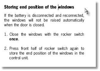

Got into car charged battery, open drivers door form inside - removed drivers door panel to gain access to back of door lever to discover plastic/nylon female sleeve had come apart from a threaded rod on back of door lever. Very simple exercise of dexterity to reassemble. Is this a problem of a worn part???? or a known issue??? door now opens perfectly fine. Next issue is window does not rise into door seal when closing, any ideas please ??? presume very simply could be a microswitch but if there a re quick fixes/tests/diagnostics would be appreciated. You might think car is a problem, but in 30 K miles of ownership several trips abroad inc N ring car is perfect. car currently has 63 K on clock so just a youngster.
