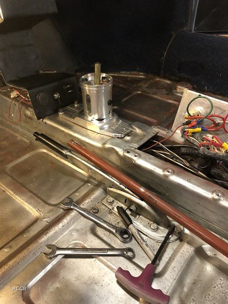

Bit of a late reply but the Rennspeed shifter works a treat in the 911 so much so I bought one for my wee beastie 356 but of course it didn't fit directly and I knew I would have to do a few mods to get it working right. There are three bolts holding the shifter similar to the 356 and although the front two line up spot on the rear does not. Also on a trial fit I noticed that the Rennspeed shifter would sit slightly higher that the 356 position. This turned out to be not a great problem as I had a Willhoit base plate fitted under my old 356 shifter, so I simply marked the new rear bolt position on this base plate, drilled and tapped it M8 1.25 and voila everything bolts up perfectly after I had chopped the shift rod aprox 3cms and filed a notch for the clamp bolt. Although I couldn't road test the car as I'm in the process of pulling the engine and trans out for re-builds the shifting function with my new slightly raised Rennspeed shifter seemed very good indeed.
