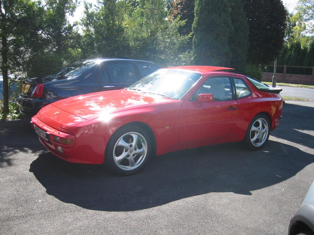

Anyone know what the offsets are on the 17" Boxster 5 twist spoke wheels? I got a set not long after I bought my car and fitted them staight away. I've had no problems with tramlining or any other handling-type issues but I have recently read that on 944's you should fit the front ones with 7mm spacer. The original wheels on my car were the 16" Teledials.
I cannot read the figures that are either side of my valve as the wheel refurbishers were a bit too vigarous when they were cleaning up the wheels and have made the numbers illegible.

My wheels are the same as the ones pictured above. Luckily I never had a tramlining problem before and still don't and i've fitted 968 castor mounts which also had no affect on tramlining so I guess I must be one of the lucky ones!
I can get the offset from Mikes link assuming that this design of wheel only came in one offset value for a given wheel width. You seem to be able to get different offsets for the Cup 3 5-spoke twists. So I assume that the difference between the offsets on my Teledials and these wheels should give me the width of the spacer as both wheels are the same width.
