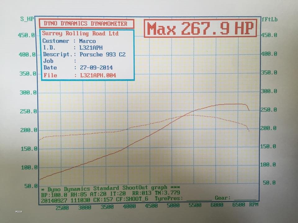

Ref Wayne's tune, I'd want to ensure that power was gained pretty evenly everywhere, not just mid range and little/no increase top end. Ideally I'd actually prefer an incrementally larger gain at the top end. Current dyno from a few years ago, not bad for an old girl with 125K on the clock at the time who in theory left the factory with 268 bhp! SRR thought she'd come out in the 250s....

Regarding the dyno tune, here's the before and after dyno from my car at Wayne's: https://we.tl/YJykN7zqfv
- mine's a varioram, which is the cause of the torque dip before the tune at low RPM's. Pretty much what you're looking for regarding improvements across the board and a little more at the top ? I can't see any negatives after the tune, the engine has more pull everywhere and runs smoother throughout. My own thought is that if cost hadn't been an issue, Porsche would have liked to have individually dyno tuned every one themselves from the factory...

Andrew, your Dyno link won't work for me .. was your VRAM playing up ?
hi maurice...strange, the link works OK for me (click download on the page if it opens)...my problem was just a low rev dip in torque, which Wayne tuned out. he explained this to be due to the mass air flow sensor getting confused by a reverberating air wave at low revs. ....it reads this as more air being present, so the mixture goes too rich. ..he tunes this out and you get the improved torque response at this low rev point.

Quick update: I was at Wayne's yesterday getting the remap done. Well worth the 500 mile round trip. 993 now driving smooth as silk and producing a little under 296bhp at 6200rpm with power added incrementally throughout the rev range - feels like she's just been dialled up to 11 [:)]
Love the fact that her character hasn't changed and you still need to rev her to get the reward - it's just the reward is now a little bigger! She seems a bit louder/angrier too now, also with a few extra burbles and bangs which is nice :p
Also very impressed that she was showing 285bhp before any work was even done - not bad for a 132K mile / 24 year old car that was only supposed to have 268bhp to start with when she left the factory! Not an engine that was built on a Friday afternoon as Wayne put it :ROFLMAO: Only non standard items are Carnewal's mufflers and an OE motorsound airbox.
