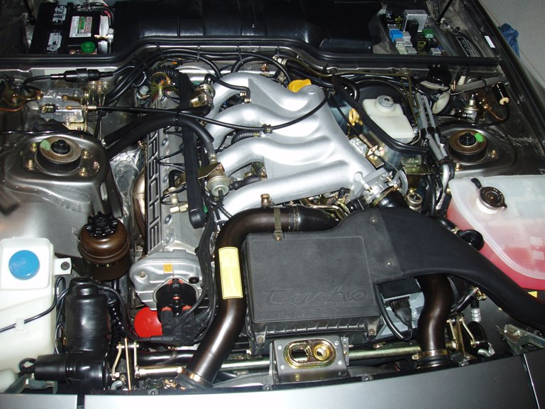

I have over the past 2 years I have spent loads of time and money improving my 944 Turbo I am now happy with the interior body and paint and it is mechanicaly sound......
Trim and body I know want I'm doing but engines and suspension I have not got a clue to help me out here
Next I what to change the suspension (don't ask why) everyone seems to rate KW but will I really notice the difference the car is not tracked ? I like the look and price of the ground control units at £700 v £1500 what would you do!
now the biggy
I want the engine bay to look new so I am going to fit a new engine I would like a bit more power, I am considering buying a new engine from Broadfoot racing in the states purely because I like to look and price, other people have quoted me 15K in the uk to build fit a 3L ........does fitting a non standard engine reduce the cars value?......should I keep it stock?
do I fit a aftermarket engine managment system for reliabilty and drivability ...does this increase/decrease the cars value
my car is NOT fully original but I think the mods (interior and bonnet) are simpathetic to car so do not detract from its appeal I have known extactly what I wanted to acheive with the car upto this point ...now I'm lost[&o]
what would you do

Build the engine yourself. They are quite a simple engine to work on and there is considerable knowledge within the forum to help you. It is always much more satisfying doing it yourself and costs much less than paying someone else to do it.
The KW stuff is very good on or off road.
Alasdair
Re kwv3 you would certainly be optimising the cars handling and enable it to utilise any engine mods you have planned. On the road having more grip, less pitch and roll and better high speed stability are all good things. Cheaper systems are available but if you can afford it now you might regret having not fitted it in the future.
In my view it's probably the single most worthwhile mod available for these cars.
Edd
KW-v3 and do the engine yourself, unless yours is terminal you could tidy it up and get a fair bit of extra power without too much time/money. Whilst the engines from the US looks very nice, I guess it aint going to be cheap!
As for a US engine, don't forget to factor in crating and shipping, shipping insurance and the dreaded VAT and import duty when it lands on UK shores. No chance of slipping that into your hand luggage and making a dash through the green channel at customs!!
Also if something goes wrong, you can't exactly deliver back to the vendor for checking over with much ease!!

Have a good think about your "more power" objectives first.
It might just be that your current setup is a bit tired - an old wastegate won't hold boost well & will be slow to spool. Do you know if the car is a 220 or 250 turbo? Has it had any mods already? Ensure there are no boost leaks, plugs/leads/dizzy cap are good etc.. Is the compression good & oil usage low? If it is then you've probably got a reasonably good starting point already.
For road driving, 300hp/300+ lbft is plenty. Easy and relatively cheap to get too. It makes a massive difference to the performance. Nothing more than chips, dual port wastegate & a few other mods. Promax Level 2 kit would be a reasonable example that is plug & play. I would have thought you could get it or something similar supplied & fitted for under £1500. Above that level it starts to get expensive. See if you can get a drive of some modified cars before you go too far..
The KW stuff is awesome, I can't recommend it highly enough for the difference it makes to the car whilst still retaining the character, and mine is a (flexible) cabriolet that I never take on the track either, although now it feels like I could!
Your car looks excellent now, but when you start talking about resale values then i think that you have probably killed your chances of getting your money back just with the detailing.
Any engines over 100k will probably have worn rings. Stuarts (scam75) car used very little oil but the top rings on the car were about 0.35mm over their wear limit of 0.8mm for the end gap. Get a bog stock early 86 forged bottom end (bulletproof!), later 03 suffix head, 250 bhp turbo and a fresh rebuild and you will be good for 100,000 miles again. Careful building will easily see you with 250 bhp for the stock motor. DIY cost of probably about £1200 -£1500 including the engine if you shop around for parts. You can pick up the Promax kit stuff for not a great deal if you keep your eyes open.
The engines are simple to do if you know one end of a spanner from the other. Everything is large and accessible with the engine out and they fit straight on a stand with no buggering around.
Alasdair
I get the impression that Ken isn't just looking for a "refreshed engine" but he also wants the NEW engine "look" to go with the rest of the car which appears exceptionally clean.
If it were me and I wanted the same look / effect but didn't have the time.... I'd obtain a decent spare engine and get someone to refresh and return it looking very very clean at the same time. I'd be concerned about buying a State side engine and having to contend with potential problems .....
Re suspension, you have spent so much and will probably spend so much more that a £600-£800 saving by not buying KW is likely to be insignificant at the end of the day.
Whatever you decide, good luck!
I'd agree with Simkin, get a UK specialist to rebuild a spare engine, Jon Mitchell, Simon Pearce, Promax etc and when you do the swap you can "tidy up" (I've seen your other work!), the engine bay.
I really love what you are doing with your car Ken, it looks truly awesome and it's already a real credit to you and your enthusiasm. To want an engine bay to match is obviously the next step but to purchase a new 3L engine at £15k to achieve this is starting to approach the realms of madness [:)]
A 3 litre with matching bolt ons will give you a HUGE increase in power which will be very difficult to use in a day to day environment. For the 'new look' and a useful increase in power I would recommend having your current engine removed and then rebuilt to standard spec whilst having each external component cleaned properly by the builder. Simon Peckham did this to mine and whilst the internals were a much bigger engine the exterior looks identical to any other 2.5 just a whole lot cleaner
Al has already given you an idea of DIY costs but I bet if you doubled that and a bit more it could be done to your satisfaction by a pro. Add a Promax L2 kit and that would be all the useable power most of us will ever need.
Going non standard will not neccesarily reduce the cars value but you will certainly get no where near back the amount you spent on it when you come to sell. I spent over £15k on engine mods to my car but when it came to sell there were very few people who would even consider buying it and I got less than a third of that back when it was sold. However a car with a totally fresh rebuild on a standard engine might well get your money back in the long run [:D]
Thanks for all the replies, I gues KW V3 gets the thumbs up
I doubt I could take on the engine build myself so yes Paul,Steve,Mike you have it bang on what I want is a "new" 944
My indi is recomending fitting steel liners, is this a good idea ?
Alasdair the forged bottom end are we talking about crank or is there more to it than that?
I visted the Midlands Tipec group tonight and their views were quite simular and I think I am coming around to the slightly modified stock engine....
