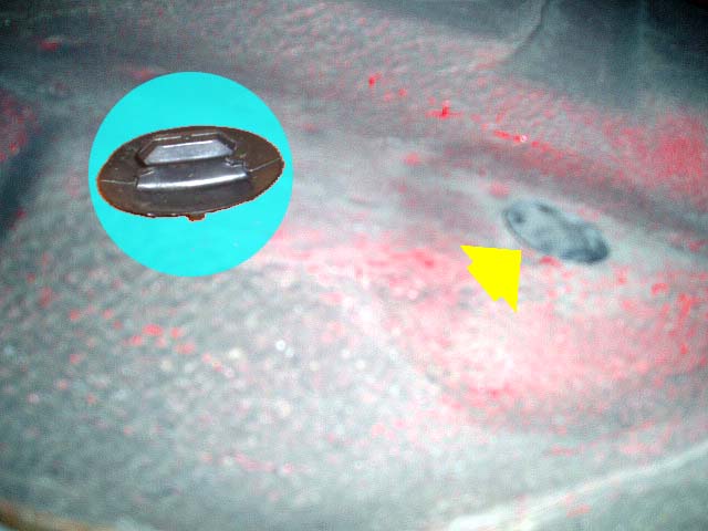

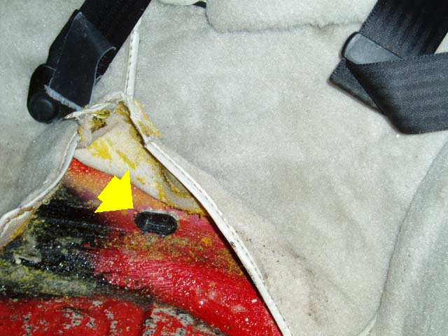

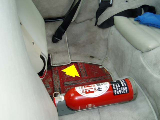

After a six / eight mile drive, but not for the first time, I found a reoccurrence of water in both Rear Footwells.
It appears after the vehicle has been stationary for a while, rather than immediately, from beneath the carpet where shown arrowed.
It has happened following a trip through a flooded road, on an otherwise dry day, so I'm suspicious that the water might be coming up from the road, rather than down from somewhere.
There is suficient quantity to run across the floor pan, if the car is parked on a slope.
Consider - The problem may not be Cabriolet, or even 3.2 Specific!
