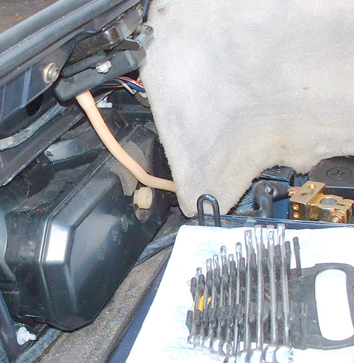

I had to replace some bulbs and clean out the rear hatch locks today so I thought I would take a picture showing two of the most common areas where rain water can enter the rear hatch area other than the sunroof.
The drain tube is attached to the rear hatch lock receptacles and quite often falls off or is pulled off un-noticed and a surprising amount of water can find its way into the boot through this fitting but by far the most common entry point is around the rear lamps.
Its impossible to see from the exterior as the lamps fit tightly into the rear valence. However if you pull back the carpet inside and look around the rear lamp assemblies after a jet wash or heavy rain the area should be completly dry.
After a pressure wash this afternoon I found quite a bit of water on and around the light clusters so another job to do is to remove the clusters thoroughly dry the lamps and mating surfaces of the valence and re-bed the lamps in in silicon mastic
