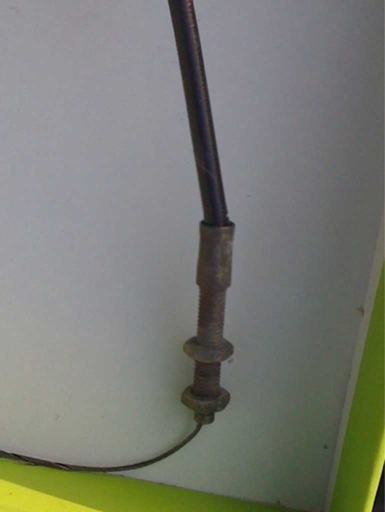

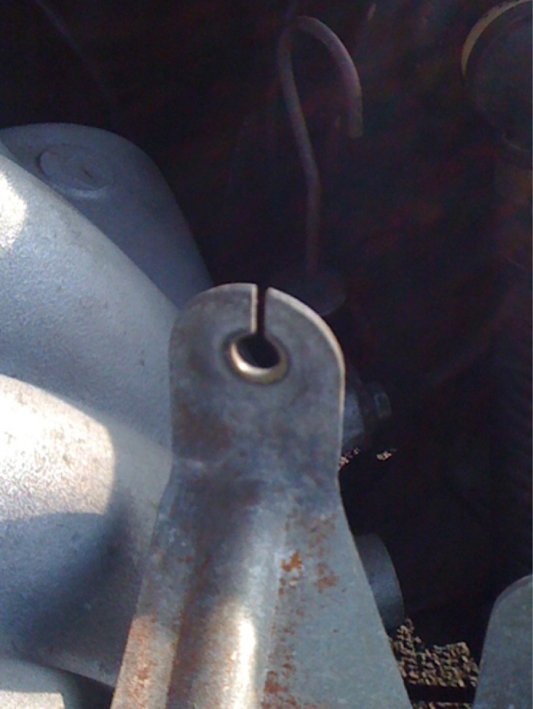

Pic of old cable end (Throttle body)
ORIGINAL: jwindwood
This is the same as my 1989 2.7, (and I'm pretty sure that was the same as my '83 2.5 too)
Edit - Just checked some photos - this is the 1989 2.7 for certain - took it last week - looks like yours I think and I know I need a new one too!

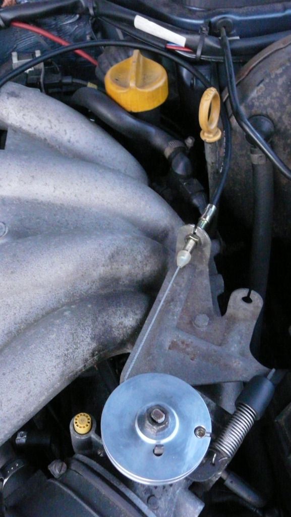

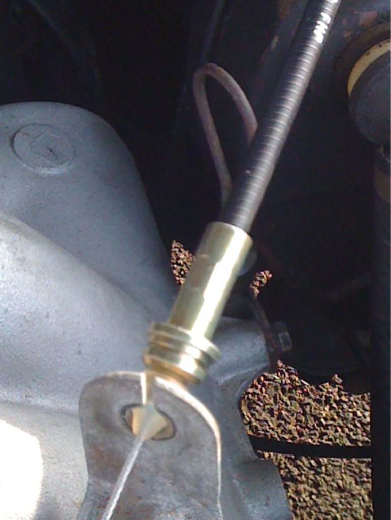

Just taken a picture of mine fitted to my 89 2.7 Lux also with fast throttle cam and adjustment at that end . The part number for the cable is 945 423 023 05
