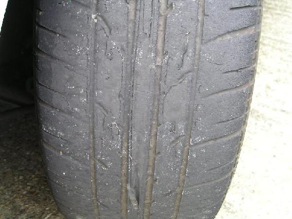

I will be changing mine this week (see pic) and have been thinking about a second set of wheels/tyres for track work, I saw Colway Traxtar mentioned in a few other posts.
