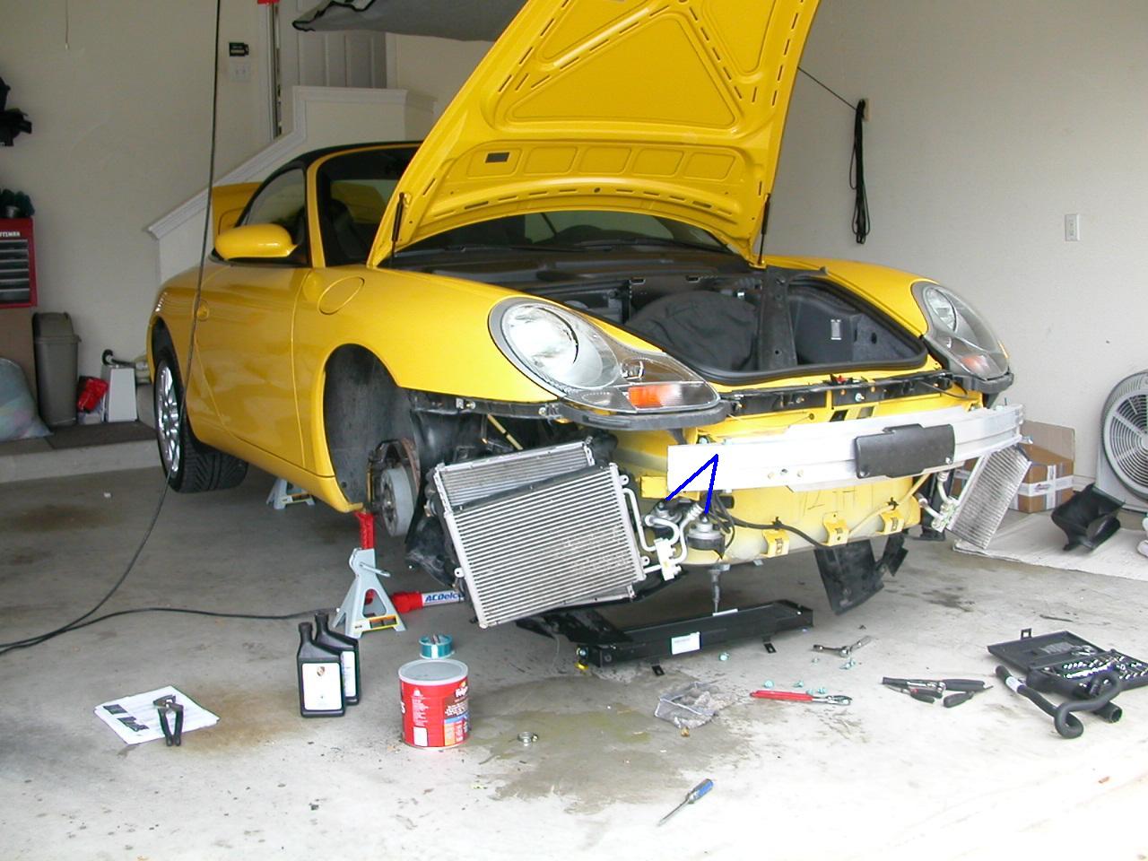

The horn you can see is the high pitch. This is the one that usually stops working. My theory is that water get into it, as the other horn is better protected by the bumper cover. The shop manual says you can remove the high pitch horn through the opening - but it is hard to do it that way. We remove the bumper cover. You have to remove the bumper cover to get to the low pitch horn.

looks like quite a big job to remove the bumper and the puddle of coolant (?) doesn't look very nice!
Interesting pic though.
