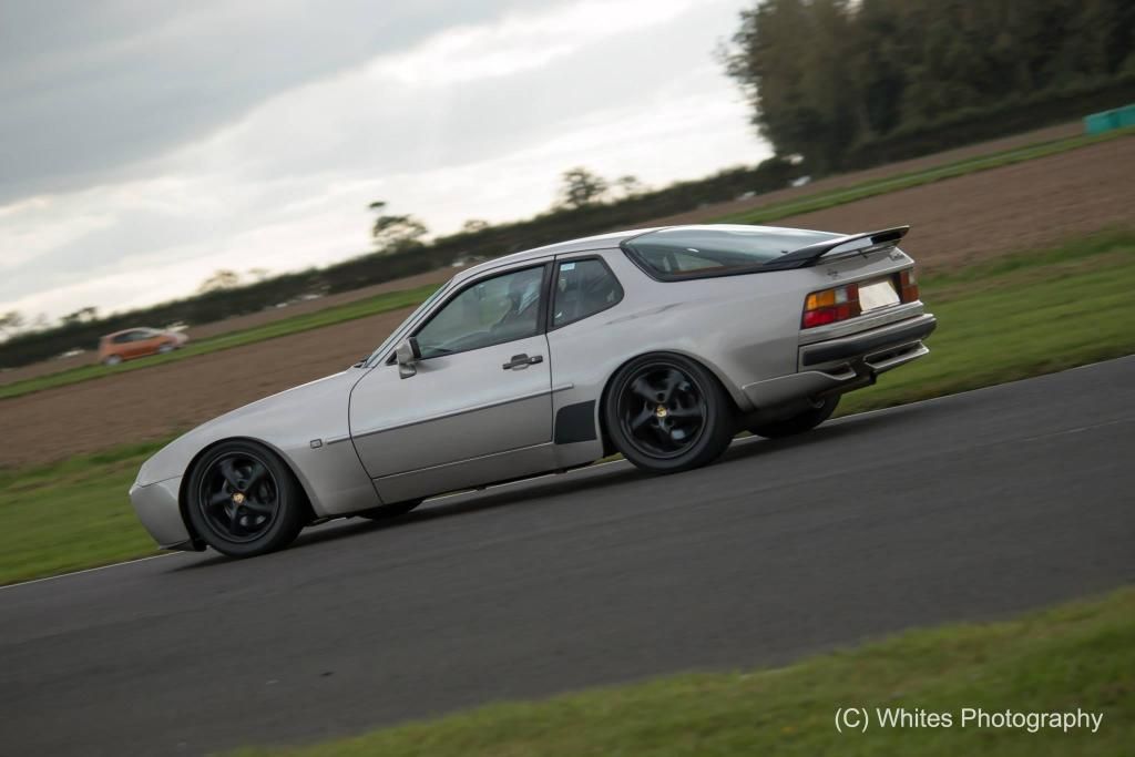

Bah humbug - I run a set of 996 C2 17" twists in black, 7J and 8.5J. They fit on a later car with no problems and open up a much wider selection of tyres at far better prices than 16".
225/45/17 front and 255/40/17 rear.

[:(] [:(] - curses..you've seen through my schemes... [:D] Yes I have two sets of 8J et40 wheels from a Cayman and Boxster which are ideal track wheels for an S2. They are probably the lightest Porsche wheels in 17" and as you say, tyre choice is good. I don't like twists of any description on a 944 though, and ride quality will suffer on an S2 cab, not to mention steering. Anyway, the OP says they are free, so why not? (my original advice on offset and width remains..)
The Boxster wheels suit the S2 quite well I think, the cayman ones, less.
If they are the 17" Boxster twists like on Eldavo's car then they are my favourite wheel for a 944, much nicer than those manky looking D90's, Teledials and Fuchs from the 80's [:'(]
Mine too are 7" front and 8.5" rear but with 205/50/17 front and 255/40/17 rear. Gorgeous in gloss black [8D]
