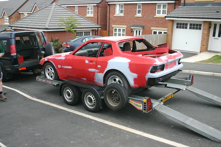

My Guards pink Lux has just been despatched to the body shop today. Fortunately very little rust to sort out and none on the sills, cleanest sills I've ever come across inside and out. The only reason for the respray is really to restore the colour and get rid of a few dings and blemishes.

There are loads of dogs out there, I've seen a lot of them. When I looked before I bought my Lux I looked at about 10, they were all rotten and in a lot of cases the owners genuinely didn't realise the extent of the damage. They just thought a couple of blisters on the sills were easy repairs without knowing the full extent of the rust on the inside. Inner and outer sills can be repaired fairly easily, but one the rust has got as far as rear suspension mounts its much more involved and depends whether the car can justify the expenditure, if its a good Turbo or an S2 then maybe yes, if its a Lux worth 2K maybe not.
