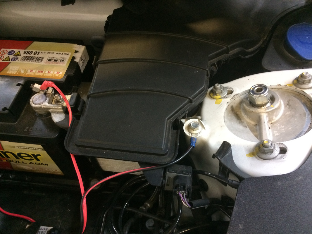

Earth to chassis and Positive to + battery post. Far left of image to the right of the suspension turret is the stud recommended by Porsche for earth connection when using crocodile clips. I use the N/S suspension turret which has an unused M6 or M8 (sorry I don't recall which) threaded hole which after removing a small but sufficient amount of paint provides a more convenient earth when using the shorter eyelet cables.
A closer view of connections and the 80Ah battery

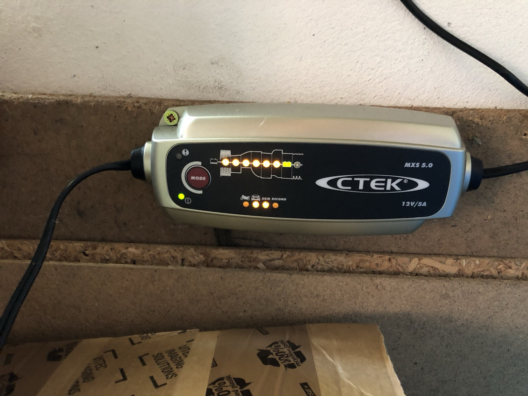

CTEK 5.0 has an AGM selection, I use that.
The lower middle two lights are lit, the others left and right are not. Car and AGM seemed the right ones to select.
ralphmusic said:Earth to chassis and Positive to + battery post. Far left of image to the right of the suspension turret is the stud recommended by Porsche for earth connection when using crocodile clips. I use the N/S suspension turret which has an unused M6 or M8 (sorry I don't recall which) threaded hole which after removing a small but sufficient amount of paint provides a more convenient earth when using the shorter eyelet cables.![]()
Thank you for this Ralph, it was very helpful.
Given this latest lockdown and the recent ice and snow in our area I’ve not been able to take my car out as I would have liked, so I decided last night to adopt your more permanent solution for connecting my CTek up to the car using your suggestion above and so far all seems well.
Does anyone know why we can’t connect the negative earth directly to the battery? Also if the car goes into the main dealer at any time, should I remove the CTek hardwiring?

Martin,
My Centre fitted the CTEK tails to the battery/top mount post and so I would say don't remove when taking the car to your Centre.
But of course on my previous Cayman S 3.8L, I initially connected the conditioner earth to the battery post; I also had a replacement battery fitted without "coding" it to the car and nothing strange happened on either circumstances. I reverted to the correct method after discussing it with some independent service agents.
As I understand it, the battery earth is part of the battery monitoring system in that it feeds data to the relevant ECU. Attaching a conditioner or charger directly to the battery earth post somehow confuses the monitoring process. It is in all the technical literature and handbook so I now follow that.
Martin,
I have to agree with Ralph and Andrew that there’s no problem leaving the wiring attached when taking the car to any dealership. After all the CTEK conditioner is offered by Porsche as an accessory, albeit relabelled Charge-o-mat.
I think you’ll find that in their user manual CTEK recommend using a body earthing point rather than the battery negative terminal.
Jeff
