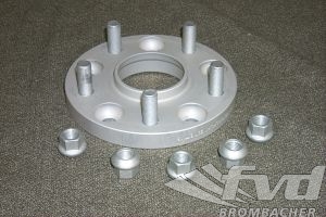

The 15mm spacers I have look like those in the picture with their own studs.

These are the plain spacer tye without the studs attatched...So i can remove the spacer at will....
At the rear ive fitted a pair of 6m spacers...
Ive removed ALL the wheel studs + fitted longer studs, so i can fit anything i want to... Also fitted steel wheel nuts...
It makes for a very varied + easy to "play around with" job....[:D][:D][:D]
