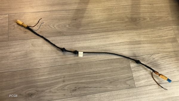

Well those 944 brake wear sensor cables have been getting on my nerves for ages and always feared during MOT time catching the Testers eyes with a fail also they just look dreadful.
Basically, if you can solder "well" and have a heat gun and the right size heat shrink tubing the cables cable refurbished to give a new outer covering giving it a far better appearance, if you do attempt the only good advice I can give is:
1) do the cuts about 5-7 cms for eventual soldering on the cables for the "fronts" up in the "engine bay" rather than wheel side as its not prone to water ingress.
2)So for the rears again do the cuts again up on the connector attached to the car body and not wheel side as again a drier locations away from moisture.
3) So remember cut the cables about 5-7cms from connector also importantly this do all cuts away from the wheel side, do staggered cuts too of 1cm for each individual cable as this enables resoldering easier as you not need to mark cable as there staggered so this method allows the cables for easier soldering having staggered cuts ....simples.....for the final soldering together again and remember small heat shrink to protect each new soldered joint so the end result aren't bunched together in the same place and the final long lengths of heat shrink appears the same diameter the entire length otherwise if the solder joints are all in the same place it will be fatter and you'll have difficulty get the final top outer long lengths of heat shrink over the soldered reconnection.
