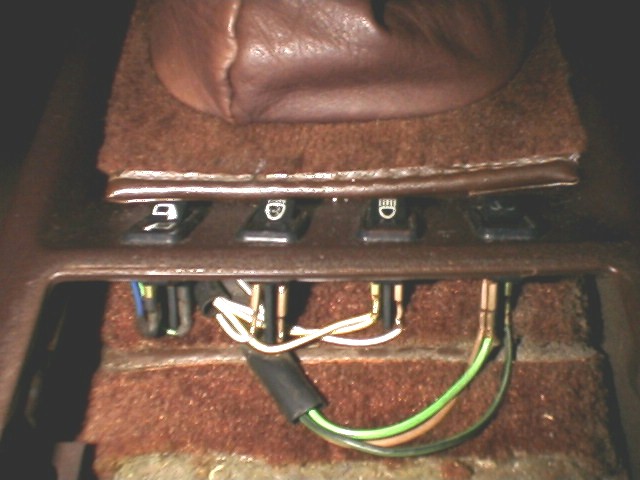

Here is a piccy of the switches and wiring (ashtray removed) in my 1983 2.0
From left to right - Door mirror adjustment rocker - headlight washers - driving lights - rear wiper
PPS although my driving lights switch appears to be wired up nothing appears to happen when I flick the switch - I suppose the 'bumper' lights are supposed to switch on? Will have to check this out if I can.

The lights to which you refer are normally wired as driving lights, selected by the switch and should come on with main beam Paul. If they dont, check the fuses and the relay.
