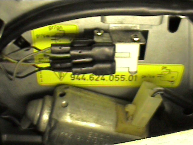

Lift arms were not working as they were ment to on my 86 car i realised that the
removed lids on lift motors to find stripped teeth on lift arms plastic cogs
Ordered full cable /Lift box setup and installed it
testing it with roof off and cogs removed the motor would only work one way in which it pulls cable out of tubes (lift i think)
The cable came right past nearside box and now i cant get it to work either way
Switch does click each way
Also noticed the limit switches are not fixed at bottom and just the blade sticking out top that keeps them attached to plate (eg i can slide both switch together back and forth )
http://img.photobucket.com/albums/v715/Theseller2121/sunroof-late-motor-switches_zps68e81036.jpg
