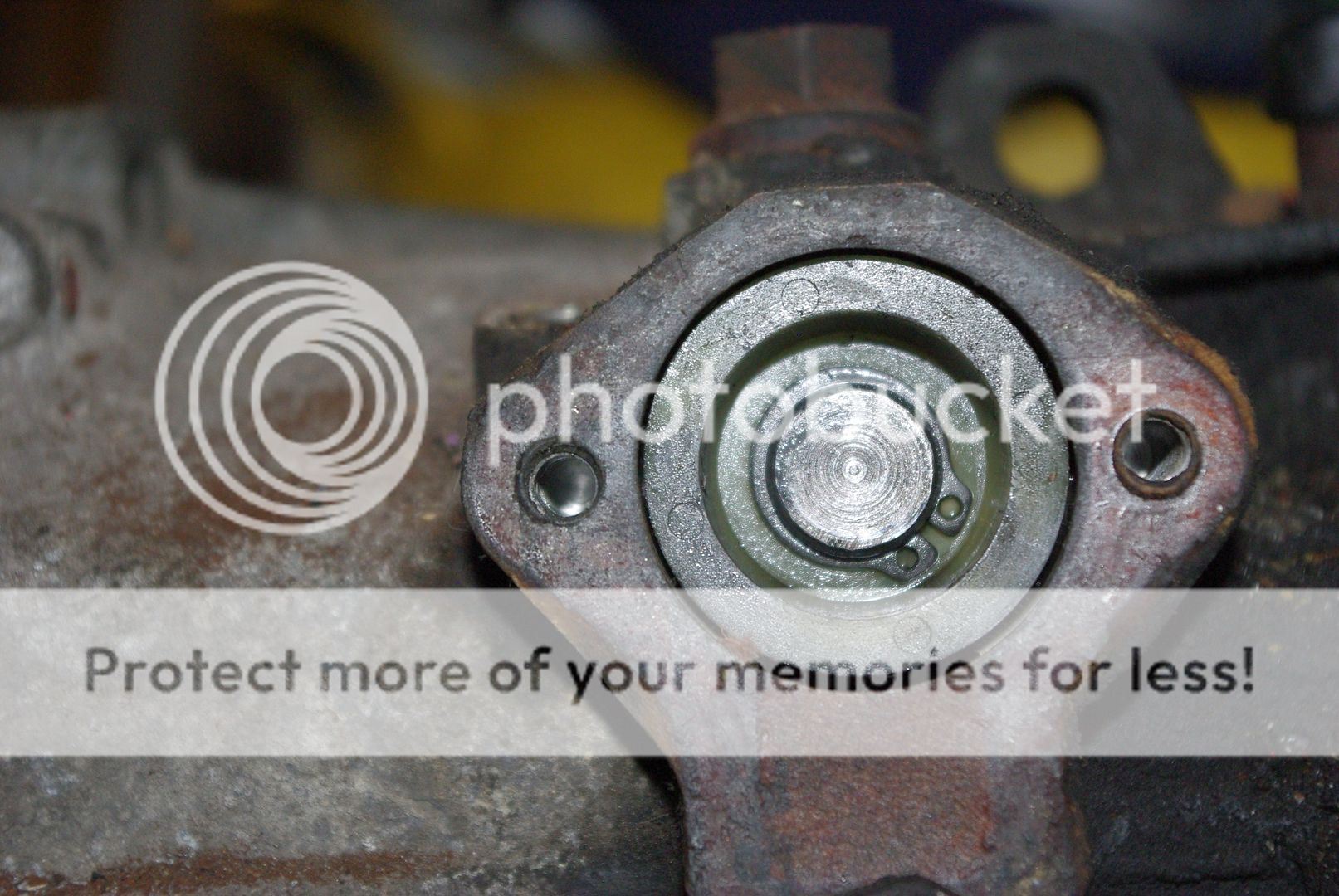

Al - I have taken the cover off my spare 'box.Both the plastic bush and the shaft are spring loaded, so you may be able to push them a bit?
Other wise you would have to take the circlip off and see what that will do.
Thanks for that Mike - really helpful ! I have been examining the workshop manual and my understanding is that the selector shatft is operated from the opposite end of the shaft to your picture and is sprung loaded to allow lateral selection of the driveshaft for 1st/2nd, 3rd/4th & 5th/reverse respectively.
My guess is that the 'key' on the selector shaft which selects which driveshaft it operates is somehow out of line and trying to operate the wrong driveshaft. If you push on the open end of your selector shaft, does it move in against the spring, as I'm wondering if a tap on the end of the shaft may do the trick ?

Yes the shaft is spring loaded (guessing mines in neutral) and moves quite easily (good prod with a socket extension!)
My guess isthat yours maybe jammed so tapping the end may free it, possibly whist wiggling the lever end of the shaft.

Ok, managed to get out there again whilst it was still light...... removed that cover, and I certainly have in and out movement with the shaft - gave it a few taps with any appropriate sized hammer, whilst moving it around in every direction possible, but nothing doing.
