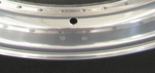

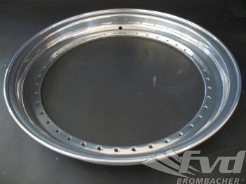

DON'T BUY THOSE.
The rims on this link are for the BBS wheel and will not fit the 993 RS Speedline. The 993 RS Speedline uses a split rim wheel with 40 mounting holes.
The rim in the link is a BBS racing wheel rim which is designed for lighter weight and only uses 24 mounting holes.
Try this link from the same site:
http://shop.fvd.de/?VID=429085&VCD=81466064&AM=1&SM=1&LM=2&MM=item&AC=item_details&item=FVD362965001&gid=245&sgid=&CarCompany=0&CarType=12&CarBody=&CarYear=1996
993 RS Speedline wheels are expensive to refurb as I'm sure you're aware. Whats interesting on the links is to see how much the bolts cost. There are 160 bolts = £380.

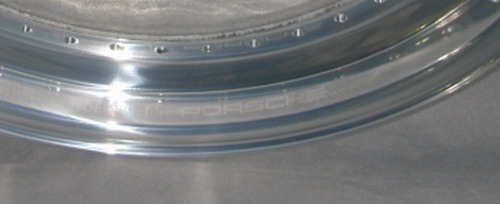

Do you know the finish on these rim edges?? polished stainless or lacquered ali??? They could form the basis of a reasonably priced refurb???

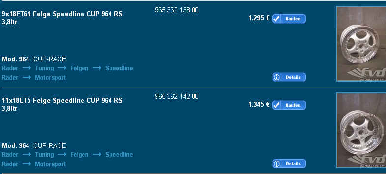

If anyone is going to contact these guys can you find out if they do the rims for a 964 cup splittie.
Also wonder if they have the Speedline for Porsche
Lee, if these are for your own 964, then I think you will need the 8 x18 ET 52 and 9.5x18 ET 47 Speedlines for the narrow bodied version,,,,,the wheels above are for the widebody I believe.
