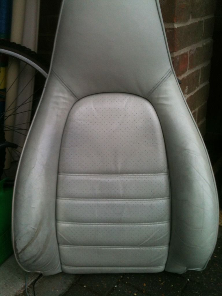

I started with this.
and after about three hours ended up with this,
I followed the instructions in the tech article by Nick Edmondson. I have given myself a skill kid award for services to renovation (basically a can of beer!)

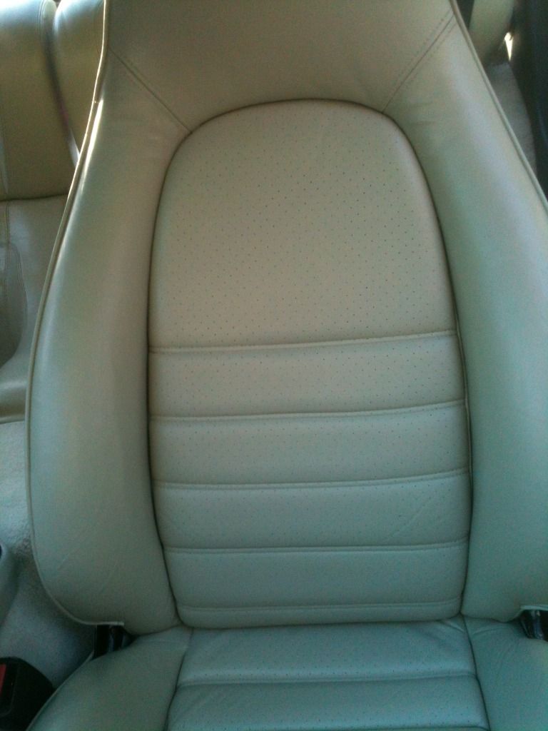

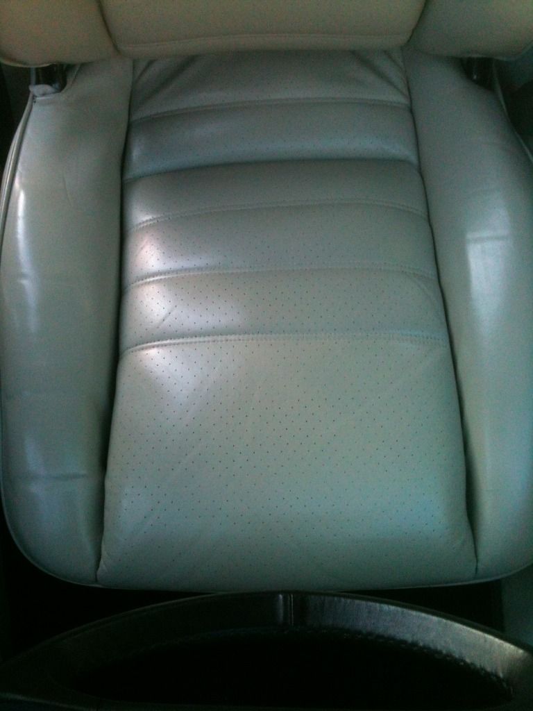

I spent this weekend recolouring my seats. I went with Gliptone products as they knew the colour (linen) and were able to post it the next day. I don't have access to a compressor but the man at Gliptone said not to bother and to use a brush. I bought a good quality 3" brush and used that. I am very pleased with the results:-
Before:
After:
I also bought a small kit of black colour from them at the same time and now my steering wheel looks like new as well!
