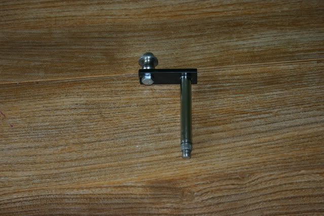

Normal problem is the joint on the drivers side where the two arms meet you should be able to see it from inside the engine bay without removing the cover under te windscreen almost next to the OS wing. The ball joint normally breaks and it can be mended temporarily with a rubber band or even a loose bolt through it. Think you can buy the joint seperate from the rest of the mechanism and may even be able to replace it without removing the cover which you have to be careful with as they get very brittle with age and are hard to come by. Mine went last year but it was the motor shaft that snapped so easier to replace the whole thing motor arms etc if you have to do this it is easier to remove the cover and heater unit to allow better access otherwise its simple to remove but impossible (or for me anyway) to refit. Think from memory I bought a secondhand turbo motor and arms for around £85 from a breakers.
Common problem, I used an O ring as tougher than elastic band. Its the plastic bush rather than the metal ball that wears - new would be best replacement and I've heard someone say they took the whole assembly out without removing the heater, but I couldn't!
There are two link rods that connect the arms to the motor, one long and one short. A quick look at Design911 has them at under a tenner each http://www.design911.co.uk/fu/prod13016/Wiper-Arm-Connecting-Rod-Short-Porsche-944-1985-91-RHD-Cars/ so I would guess that Exeter Porsche will be even cheaper.

If you are careful it is possible to drill through the ball joint and the mechanism arm and secure them together using a nut, bolt and washers - a bit fiddly though, and you need to remove the motor and mechanism from the car and strip it down
