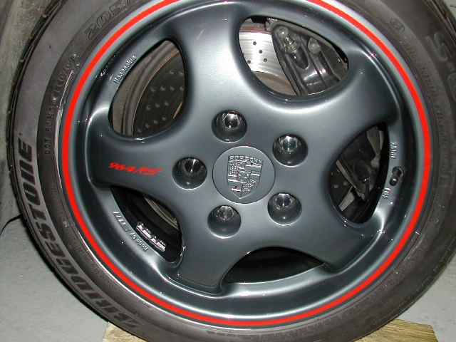

In a fit of "baby & bathwater" I took my wheels away from Prestige and decided to do them "myself". My son is a Porsche trained paint sprayer so I had him dry prep the wheels, acid etch prime them and then paint them.
The colour and general appreance will probably not appeal to all but all opinions welcomed, good or otherwise.
I zymol'd them today and have now refitted them, see for yourself....
Allan
Interesting colour, but they do look very chipped, which I thought was a bit odd.
Not sure about the red ring.
What colour is the car ?
But, at least you got what you wanted, which is all that matters.
look good to me. Colour ok with right colour car of course and quite like the red ring but guess wont be to everyones taste. How bad were they before?
Car is Indischrot [Guards Red] and the "chips" are just reflections from the camera flash.
The wheels were in really bad order, previous refurb was poor quality.

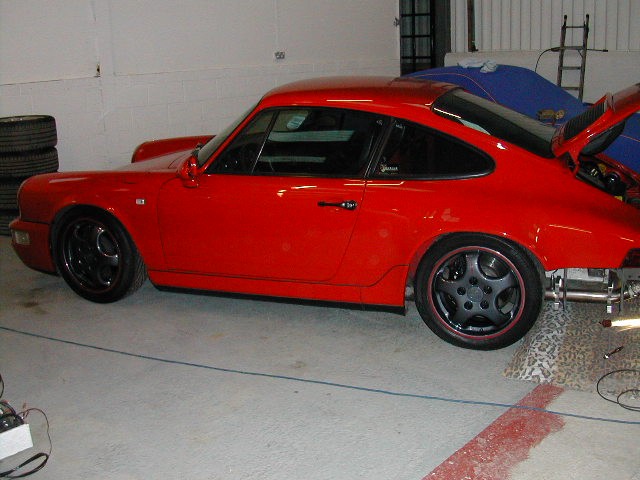

I like the colour myself Allan , post a pic of the side of the car with wheels attached and lets see............

The colour is Anthracite. My wheels had been painted poorly at least 3 times before and were in $h!te order. Therefore they took lots of man hours to hand prep. I believe it was c3 days prep time plus paint time plus materials. He did say if he had to do more it would be £150-£180 per wheel depending on condition at outset, so new ones would be £150 per wheel. This is probably more than the 2 recognised refurb establishments but it includes any graphics of your choice. I am sure there would be a further reduction if no graphics were required.

Lawrence they were mainly rubbed down dry as I was very frightened of water ingress due to the porosity of magnesium, some water had to be used but it was sparingly used. No wire brush used but a DA sander was used on the very scaly bits. No chemicals were used it was all done manually.

ps Added side on photo of car still undergoing work.

I painstakingly hand applied Zymol Titanium to each wheel inner & outer so that brake dust vanishes with a quick squirt of water. That was the plan we will see what reality brings

For anyone else contemplating work on their mags, a word of warning.
The magnesium alloy, once exposed, oxidises much more rapidly than the aluminium alloys normally used for wheels. As a result any chemical preapration and etching of the surface has to be much more agressive to break through this oxide layer. Normal etch primer or standard pretreatment chemical setup may not work suffciciently, leading to poor paint adhesion and poor corrosion resistance.
Irrespective of the wheels you have, if they are being refurbed always ask for a step by step breakdon of what they're going to do. If they can real this off straight away then they know what they're doing. If they look blank, walk away and find somewhere else.
