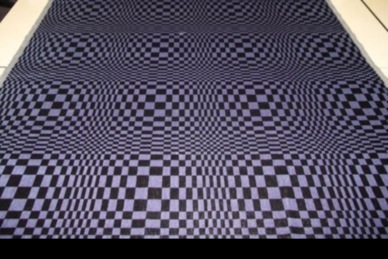

Lol thanks for your help. Tbh I did think that myself here's a pic of some just off the roll what you rekon I think it do able looking at the pattern
Ash, theres quite a leap between realising that you need more and being able to accurately estimate your requirement. Id suggest getting a good picture of the material unrolled and the seats showing the pattern placement, and email a decent trimmer.

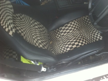

nice seats - bear in mind the fabric may be 30 years old and the fabric will be tired and start ripping on the seems and a restorer might not be able to work with the old fabric .... just saying
Frank
Think it's worth ago seeing as material and shipping will come to more than I'm buying the seats for and my old dried out seats will come in very handy as a couple of gaming chàirs for the man cave
Ill keep you posted on how they are thanks for your help everyone
Yes, especially with early style seats. The material has gone when the seams part and it can seldom be repaired. Series two seats have a fold to relieve the pressure on the seam.

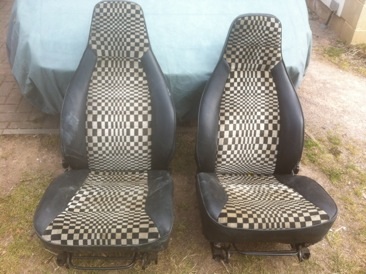

My nice refreshed seats just need a clean and original runners replaced and jobs a good un
Looks good I think
