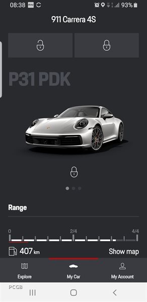

I have had LOADS of trouble with the Connect Services in my 992... Any chance you could post a screenshot of your app showing your car on the 'My Car' screen of the App? I've had my connect computer changed in my car and now the car that is displayed on the App screens is just a generic car... i.e. wrong colour, wheels, seats, no glass sunroof... My dealer seems to doubt me when I tell him it showed a good representation of my car before the computer swap!
Paul
Paul, see attached. This reflects my car, e.g. carbon fibre roof, rims, etc.

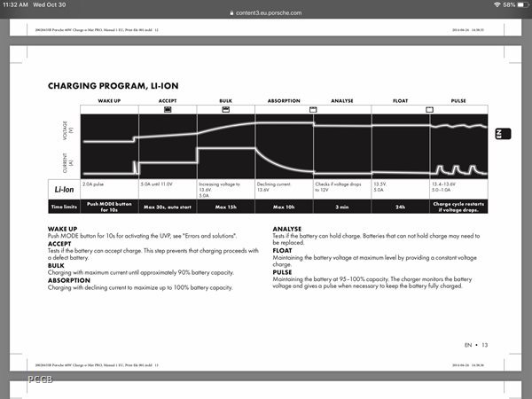

And this one from the porsche version. As can be seen the intial phase is different!
Sorry haven't quite got the hang of uploading photos yet!
Dave

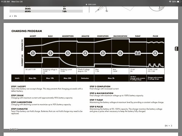

Lancerlot said:
Those are for different battery types though, aren't they?
Regards,
Clive
No, the top one is for the ctek XS lithium and the second for the lithium mode on the porsche charger.
