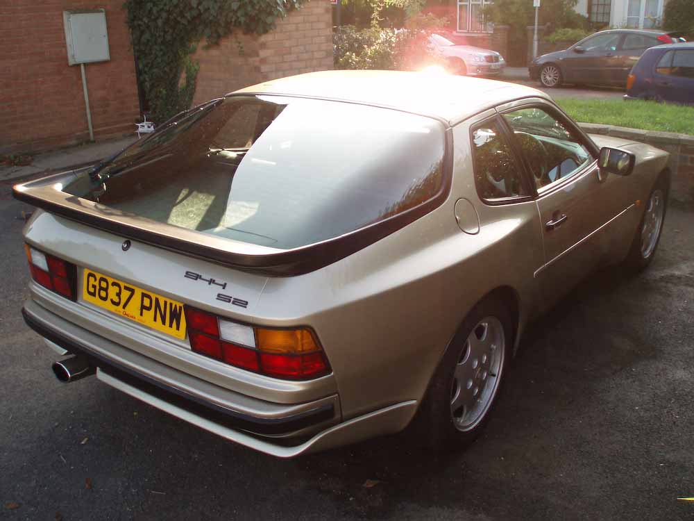

I had mine removed prior to it being resprayed and apparently it didn't damage the paint but it wouldn't go back on again so I still haven't got around to replacing it looks good without the rubbing strip on the bumper though.
http://i143.photobucket.com/albums/r159/JonathanLavis/944S2rear-1.jpg
