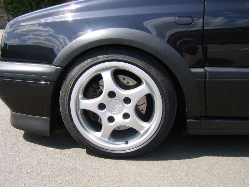

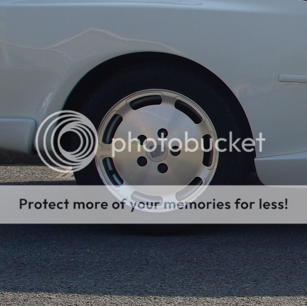

These are forged, like the Club Sport ones and quite rare in 944 offset 7" 55 and 8" 52. There are also 928 versions on the market but most of those are the wrong offsets.
Cup 1's are 16' and about the lightest available for the S2 (apart from rare mag teledials for turbo cup cars).
(not on 944 sorry)
Edd

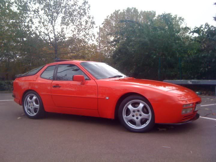

Nice pair of D90's refurbed by Lepsons would be spot on imo.
http://www.porscheclubgbforum.com/tm.asp?m=475368&mpage=1&key=lepsons%F1%B4%87%B7
Edd
Edd, was the Golf yours ?
