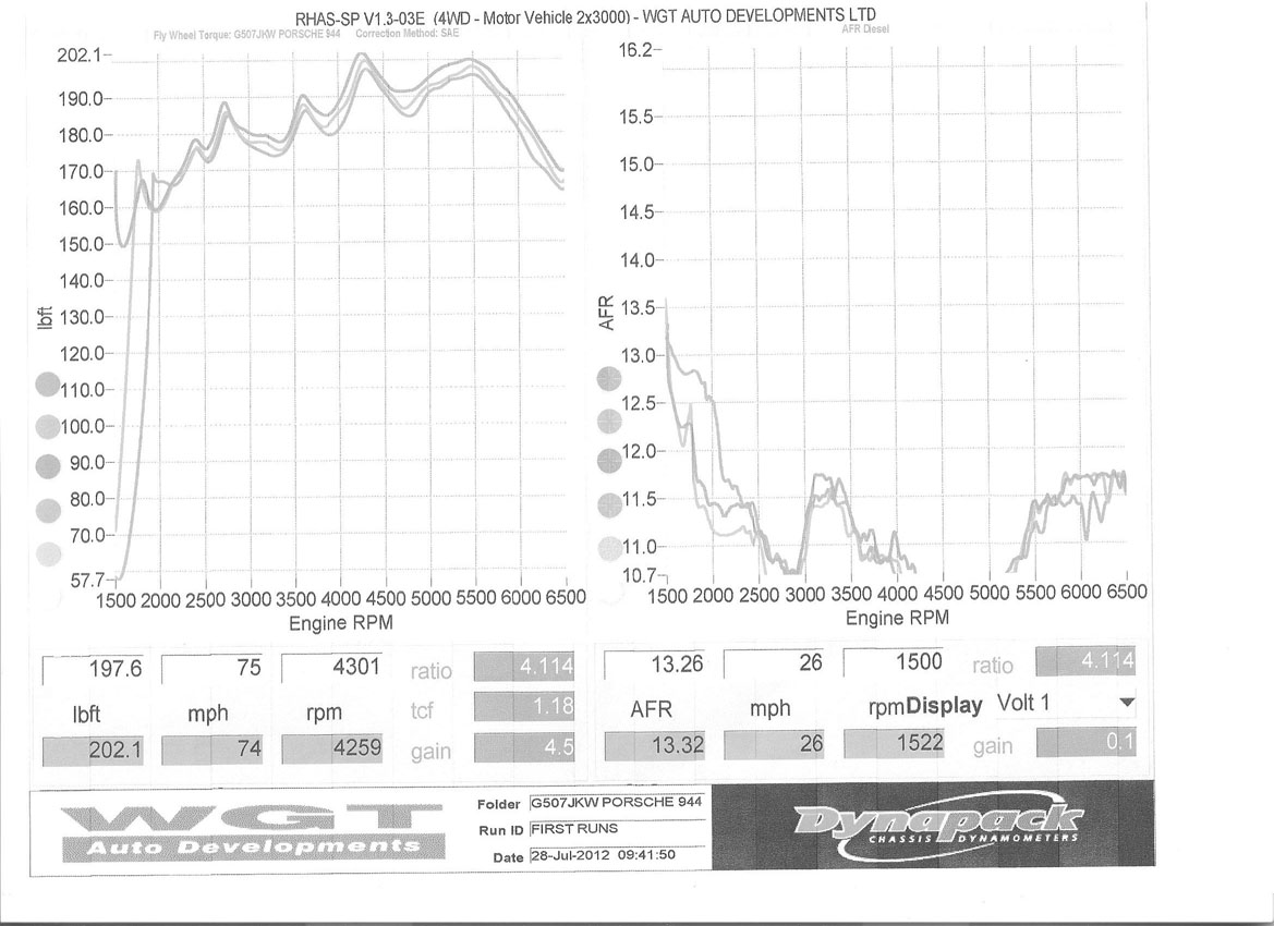

Hi All,
I finally found the time to get my S2 on a dyno and its confirmed what I've thought for a while - its running very rich. I'm not sure whats causing it though, I've checked the vacuum lines on the FPR and there no fuel there. I'm not exactly sure what i can do next apart from replacing the damper/FPR. Or possibly take it to Wayne at Chipwizards, but if its a mechanical problem I cna't imagine that would really solve the problem.
Has anyone any ideas as to what could be causing the engine to run so rich?
