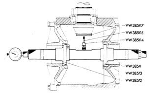

If I understand correctly, the key to properly achieving quiet running comes down to accurate shimming of the ring and pinion gear positions to suit the tiny changes in position due to the new bearing tolerances (assuming your gear teeth are in good condition).
I tried to follow the workshop manual procedure, but my search fell at the specialist tooling hurdle. Most operations can be done with a standard dial indicator. However, determining the relationship between the diff axis and the pinion axial position is a little bit more tricky.
Factory tool used in the ring gear / pinion shimming process

Found a spec in the factory manual for ring-pinion backlash.
0.15mm (+/- 0.05) measured at 90mm from the diff output flange ctr. => 4 measurements at 90° intervals => Max permissible deviation 0.05mm.
I plan to check mine and report back. Pending the results, I may have another crack at the shimming.
