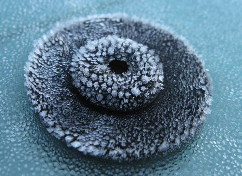

Got rid of mine. Replaced with a flat bolt and the original washers painted black: Here's a picture which was taken in frost.
There's a nyloc nut on the inside and it's sealed with something or other. Can't remember what.

The Promax bung is a really nice solution though. Best value-for-money change I made to my last car.
£20 for a 25mm blind grommet that would cost about 15p doesn't sound like a great solution to me - or is there more to it?
It's just an aesthetic thing. The Promax bung is a nice piece of machined alloy, coated a good shade of black, sealed with a rubber O-ring that seats into a machined groove. It's well-made and a perfect fit. It looks good. Looks OEM, in fact.
I know it's a personal preference, but I would never be happy with anything on my car looking home-made. I want it to appear perfectly engineered, as far as possible.
Horses for courses, I think.
