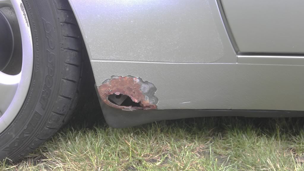

Our S2 cab has had a bubble since when we bought it, on the rear sill. I knew it looked like rust and that it was a common area where they do rust.
I am more than capable of the repair but just asking if there any good pics to follow or flow of idea's.
My only worry is matching the stone chip to be honest.. I can blend in the paint.
Also I guess an area of concern is that stone chip protection panel that is stuck on.. I guess I could paint over it but would rather have it off for a new one.
I am going to strip the body kit part of the sills off and steam clean both sides of the car to inspect under there incase it's hiding more..
I don't think it is.. but I will want to check..
I have seen the repair panels on ebay but it looks a simple shape to remake..
I am not going to bodge it I want it right and I want it solid metal.
I have a fair number of rust treatments I can get in there to protect it.. afterwards..

When you say the back of the sill.Is it the sill or the bottom of the rear arch? A photo of the area up close and at a distance would help.

pic later for sure. it's in front of the rear wheel lower wheel arch edge
like in this pic this area but not as long as this prob only 10cm's at best with 5cms showing at the mo..

Ok will my enderscope arrived from Ebay today and I got it rigged up on the net book and went out and dived in the sill area and took a look.. it was like diving on a ship wreck !
but all was good.. in fact the inner sills where really good NO rust ! none zip nothing..
How ever that rear corner where the rust is.. has a damp patch now the rain has been falling and I recon that is what has happened water has got into that rear part of the sill and started to rust it out. From the inside out.. So no option but to cut it open.. Lucky that this is localised to here and not the whole sill..

how ever it's the other way that I have a hole I am not worried because I can repair this with new metal and again any one wanting to buy one of my car will know it's been done with new metal and not filler and a nice coat of paint. I never do that and any of my cars I have restored to new have had new metal , it's the only way to go .
Here is our S2 cab
I think there is another issue here. I know they all rust here so that's some thing we all know about
But I left the car out in the rain last night and I felt inside the rusty area and It was WET!
so that means the water is coming in from some where else when the car is standing still. Having no where to go it collects in the sill and rots it out in time so I will open it up more the hole and get my camera in there with a hose of water and look to see where it's coming from for others to see..
If not then it's part of the design as all 944's go here.. and I will make holes for water to escape and treat the metal and wax oil the whole area to allow water to run off and exit with out any internal damage.
Seeing this is more a relief for me, as mad as that sounds..but knowing you have a rusty hole only this big is better. Because if your sill is nice and perfect then I am sorry that means your car has in the past had a repair and it's more likely to be filler and paint this means it will come back worse!! so get them camera's in there..
That bit is only a double skin.So a decent welder/fabricator will fix that with fresh netal no problem.It's a really easy repair a couple of hours and then a bit of paint etc and your away.
your rust spot is just a little further back than mine but the same area. I think you are quite right about there being a common water ingress point there somewhere . It could be from the roof gutter drain or the rear quarterlight almost anywhere as its surprising how remote water ingress points can be from the visible damage point.
