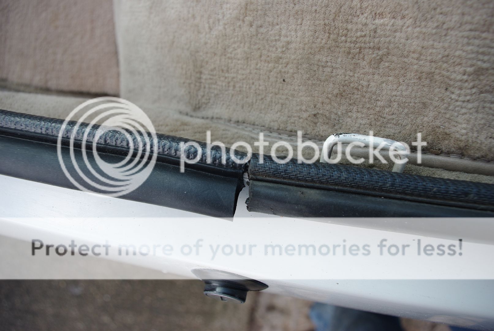

Adjusting the hatch pins may work but on my '83 the seal looked ok and didnt leak but a new seal does make quite a difference -

If the seal's original, a new one can't possibly fail to be a good thing. Didn't someone find the same profile seal available by the metre recently?

Agree with all here - all these seals shrink with age so a new seal will absolutely help. In fact - I would change the seal first and then look at adjusting the pins/latches as you may find a new seal takes up the slack. If you adjust the pins to the old seal and then put in a new (fatter) one - you might find closing the hatch more difficult.
I found the profile and ordered it by the metre from a seal supplier a few years back Paul, i'll try and dig out the details over the weekend when I'm home - away with work at the moment. Pretty sure it was 30 quid or less, I remember it being a lot cheaper than buying a '944' seal from anywhere

I heard about the seal by the metre and bought from Frosts ( www.frost.co.uk ). Sold as Side Seal and 5 metres will leave some spare. Worked on my Lux.
Lots and lots of other interesting stuff there too.
