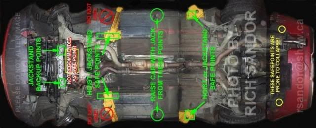

There are a number of different locations, to me the two I use most frequently are:
rear - under the aluminium axle carrier - flat plain ali where the axle pivots.
front - under the chassis rails just behind where the brake/ fuel pipes cross over. Or, under the rear track control arm mounts = castor mounts.

Always worth showing this pic again. [:)]
It's dead easy - do one side at a time.
The main jacking point is in the middle of the sills - if you still have the porsche sills on the car there is a diamond shaped mark showing the location.
You can lift the rear of the car with a jack under the gearbox (jack the main part of the box, not the end piece) but I have heard some people say that it doesn't do the gearbox mount any good..
As Chris said there are plenty of good options for axle stands
