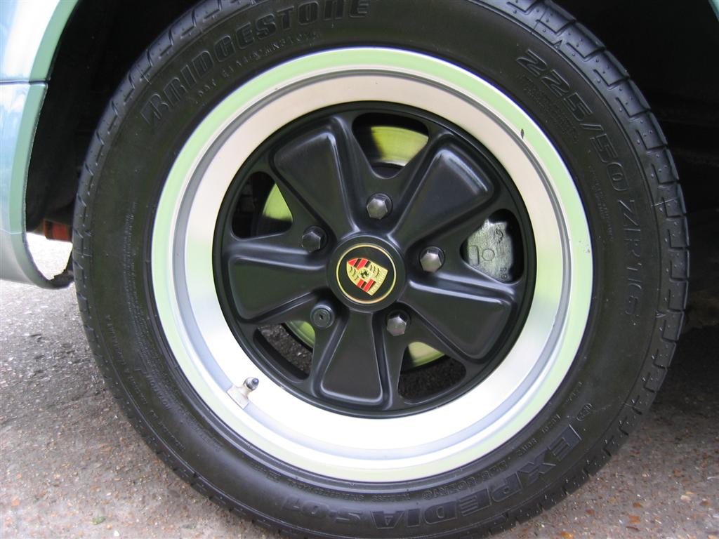

Richard Savage
Good lookin' wheel, but I've done some more work on it for you. Free of charge!
R.
Richard Savage
You're welcome! Believe it or not, that missing locking wheel nut cap is available, as a separate item. One of mine was missing when I bought the car but it turned up amongst bits and pieces when I was cleaning up under the hood. It had lost it's 'snap', so it's held on with double sided tape!
